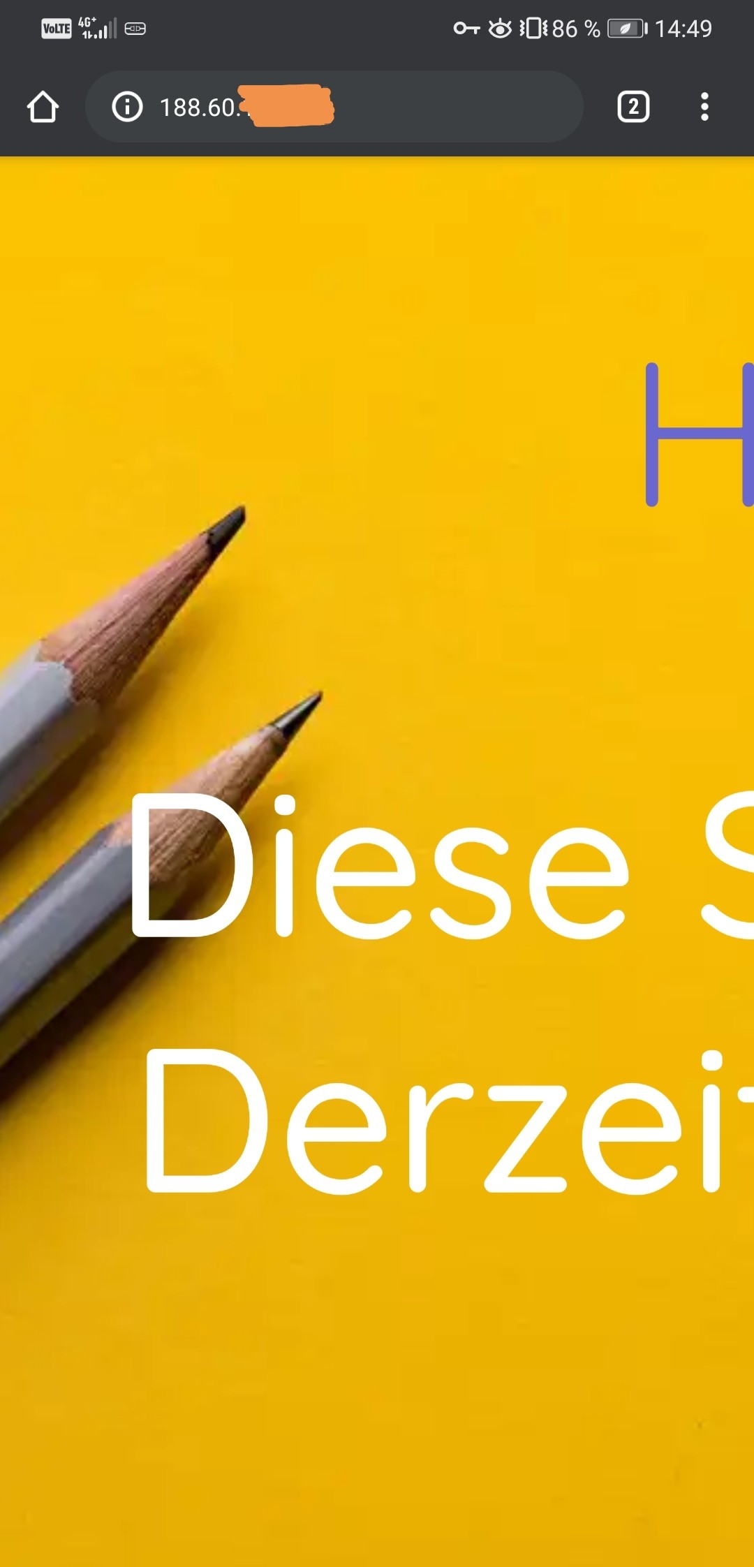

- LAN IP address: works
- Public IP address from outside the network: works
- Public IP address from inside the network: ERROR

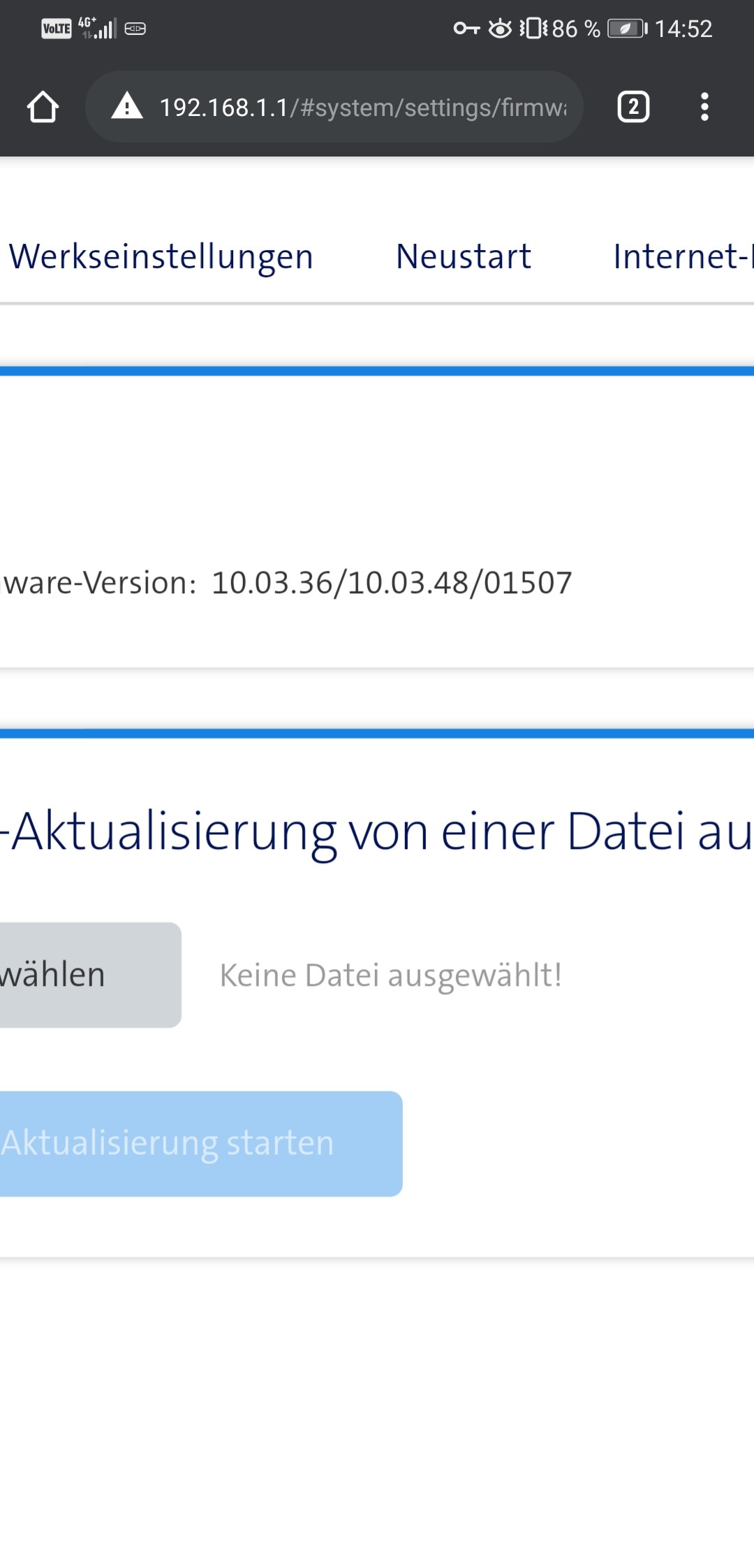

This is usually a problem with hairpinning from the router side and it seems that a new version of the firmware might have been released.
Is there any way for me to either get a version where this still works or to fix it?
