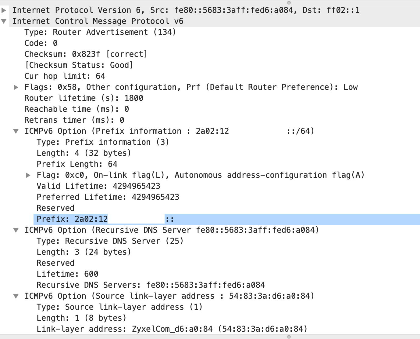

As mentioned by @lucaberta he cannot change the advertised MTU on LAN side.
So your scenario explains why keeping MTU 1480 on client/LAN side will still trigger the failure even though the MTU on the 6rd tunnel is lowered. Reason is simply that the TCP MSS is kept and the response never gets delivered and the webserver is also not informed that the package got dropped on its way back.

I don’t claim to be an expert on the topic and your explanation perfectly makes sense with a 6rd tunnel on a Swisscom IB where clients use wrong MSS of 1480 even though the IB announces 1472 on router advertisement frames to the LAN.
