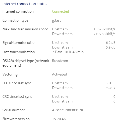

For the record, I will attach the screenshot I took from the router.
