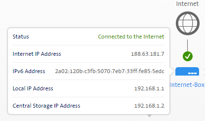

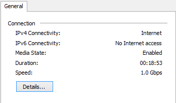

In short: IPv4 works like a charm, IPv6 does not (devices get IPs, but no Internet connectivity)
Here are my settings:
Internet:
Firmware: 06:01:13 / 05:00:32 / 813
Connection: Fiber (Vivo L 200Mbps)

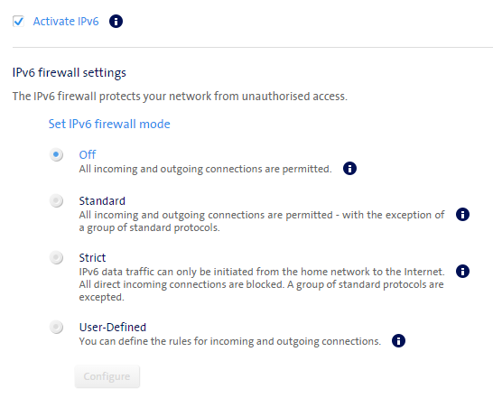

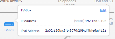

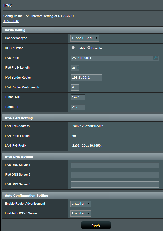

The router is configured to be in the DMZ, Box Network is 192.168.1.x, and routeur Serves IPV4 10.0.0.x
Router is in Wireles router mode, not the access point.
Configuration of the different elements:

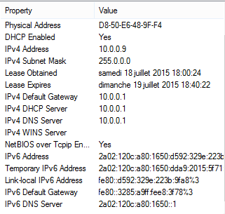

For some reasons when i add a DNS above (EC: OpenDNS: 2620: 0: ccc:: 2), my iPhone show up in the status window below... butwith Or Without DNS, the result is Exactly the same: no internet Connectivity
I put the full IPs below:
Here are the results from usual commands:
Ethernet adapter Ethernet:

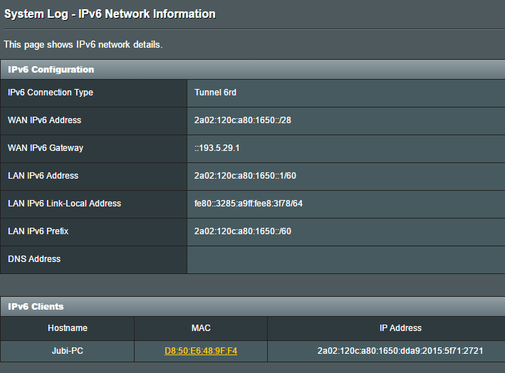

Connection-specific DNS Suffix.:. Description,,,,,,,,,,: Intel (R) Ethernet Connection I217-V Physical Address.,,,,,,,,: D8-50-E6 -48-9F-F4 DHCP Enabled.,,,,,,,,,,: Yes Autoconfiguration Enabled.,,,: Yes IPv6 Address.,,,,,,,,,,: 2A02: 120c: A80: 1650: D592: 329E: 223b: 9fa8 (Preferred). Temporary IPv6 Address,,,,,: 2A02: 120c: A80: 1650: dda9: 2015: 5f71: 2721 (Preferred) Link-local IPv6 Address.,,,,: FE80:: D592: 329E: 223b: 3 9fa8% (Preferred) IPv4 Address.,,,,,,,,,,: 10.0.0.9 (Preferred) Subnet Mask.,,,,,,,,,,: 255.0.0.0 Lease Obtained.,,,,,,,,,: Samedi 18 juillet 2015 18:00:24 Lease Expires.,,,,,,,,,: Dimanche 19 juillet 2015 19:21:27 Default Gateway.,,,,,,,,: FE80:: 3285: a9ff: fee8: 3f78% 3 10.0.0.1. DHCP Server,,,,,,,,,,: 10.0.0.1. DHCPv6 IAID,,,,,,,,,,: 483938534 DHCPv6 client DUID.,,,,,,,: 00-01-00-01-19-E9-1B-32-24-0A-64-49-B3-E9 DNS server.,,,,,,,,,,: 2A02: 120c: A80: 1650:: 1 10.0.0.1 NetBIOS over Tcpip.,,,,,,,: Enabled
ping -6 www.google.com
www.google.com Pinging [2A00: 1450: 4013: C01:: 68] with 32 bytes of data & colon; Request timed out. Request timed out. Request timed out. Request timed out.
Ping statistics for 2A00: 1450: 4013: C01:: 68: Packets: Sent = 4, Received = 0, Lost = 4 (100% loss),> Tracert -6 www.google.com
Tracing route to www.google.com [2A00: 1450: 4013: C01:: 68] over a maximum of 30 hops:
1 <1 ms <1 ms <1 ms dynamic.wline. 6rd.res.cust.swisscom.ch.0.2.1.2.0.a.2.ip6.arpa [2A02: 120c: A80: 1650:: 1] 2 * * * Request timed out. 3 * * * Request timed out. 4 * * * Request timed out. 5 * * * Request timed out. 6 * * * Request timed out. 7 * * * Request timed out. 8 * * * Request timed out. 9 * * * Request timed out. 10 * * * Request timed out. 11 * * * Request timed out. 12 * * * Request timed out. 13 * * * Request timed out. 14 * * * Request timed out. 15 * * * Request timed out. 16 * * * Request timed out. 17 * * * Request timed out. 18 * * * Request timed out. 19 * * * Request timed out. 20 * * * Request timed out. 21 * * * Request timed out. 22 * * * Request timed out. 23 * * * Request timed out. 24 * * * Request timed out. 25 * * * Request timed out. 26 * * * Request timed out. 27 * * * Request timed out. 28 * * * Request timed out. 29 * * * Request timed out. 30 * * * Request timed out.

Interestingly, pinging the modem from the PC does work
ping -6 2A02: 120b: c3fb: 5070: 7eb7: 33ff: FE85: 5edc
Pinging 2A02: 120b: c3fb: 5070: 7eb7: 33ff: FE85: 5edc with 32 bytes of data:Reply from 2A02: 120b: c3fb: 5070: 7eb7: 33ff: FE85: 5edc: time = 2msReply from 2A02: 120b: c3fb: 5070: 7eb7: 33ff: FE85: 5edc: time = 1msReply from 2A02: 120b: c3fb: 5070: 7eb7: 33ff: FE85: 5edc: time = 1msReply from 2A02: 120b: c3fb: 5070: 7eb7: 33ff: FE85: 5edc: time = 1ms
Ping statistics for 2A02: 120b: c3fb: 5070: 7eb7: 33ff: FE85: 5edc: Packets: Sent = 4, Received = 4, Lost = 0 (0% loss),Approximate round trip times in milli-seconds: Minimum = 1ms, Maximum = 2ms, Average = 1ms

1 <1 ms <1 ms <1 ms dynamic.wline.6rd.res.cust.swisscom.ch.0.2.1.2.0.a.2.ip6.arpa [2A02: 120c: A80: 1650:: 1] 2 1 ms 1 ms 1 ms internetbox.home [2A02: 120b: c3fb: 5070: 7eb7: 33ff: FE85: 5edc]
